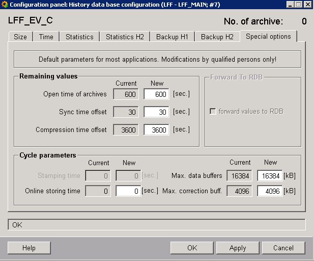

We are having one requirement to archive 30000 values and 30000 events . We alredy created 10 archive class with 5000 dpe elements and 7000 values archive.
But we dont want to change the archive file on daily.
Here I have attached the one archive class screen shot ; the remaining archive class are the same.
Sometime we are getting the error "DPE not present in archive" ; while we are cross checking the value archive internal datapoint the error number is 132. After I will click Ok in the database management archive configuration panel the error getting disappeared. Please give some more details about this error.

Hello,
the screenshots only show the "Special options" for the same archive 5 times.
Normally there is no need to modify these settings.
What is meant with "30000 values and 30000 events)?
Does it mean that you want to save values for 60000 dp elements?
In that case 10 archives with 5000 elements per archive will only allow to store 50000 dp elements.
