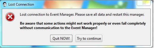

A message box appears after loss connection with the both redundant servers:
I click on "Try to continue".
After that Vision module remains but there is no re-connection to the Event Manager.
Requires restart of UI manager on a remote UI.
How can I solve this problem?

In all versions < 3.14 there is no auto-reconnect feature.
You can use pmon to start and restart the UI and set the showQuitDialog option to 0
